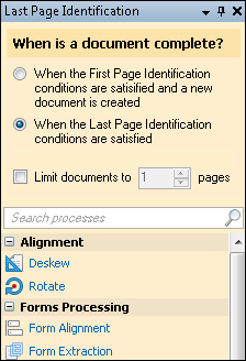

  1. In the Session Configuration Pane, select the Last Page Identification stage under the Closedname of the document class the documents will be assigned to.
  2. In the Tasks Pane, Closedselect if you want the document to be defined as complete when the First Page Identification conditions are satisfied or when the Last Page Identification conditions are satisfied. You can also select when a certain number of pages have been assigned to a document. The following steps assume you select when the Last Page Identification conditions are satisfied.

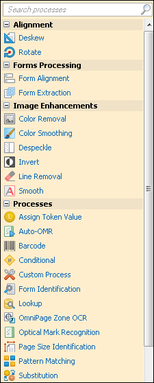

  3. Select the Closedname of the process.
  4. Configure the properties of the process. For more information, use the wizard and the help files for that process.
  5. When you encounter the Identification Condition property, follow the steps described in the Identification Conditions section of the help files.

Note: You will not be able to add, drag, or copy and paste processes to the Last Page Identification stage unless When the Last Page Identification conditions are satisfied is selected in the Tasks Pane. The stage itself will not expand for configuration without having this option selected.
