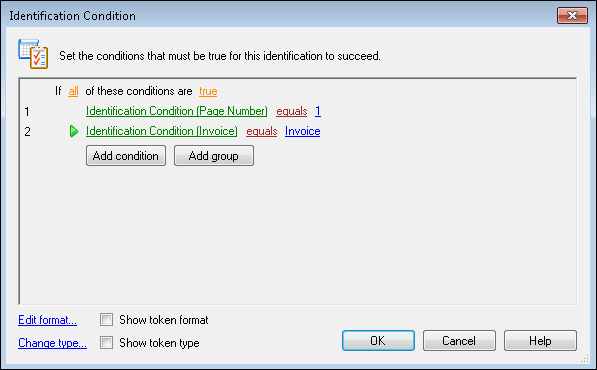

Example using OmniPage Zone OCR
Caleb and Associates processes multi-page invoices and purchase orders daily. The pages of each invoice have the word "INVOICE" in the top left of every page and each page is numbered. Because "INVOICE" is at the top of every page of an invoice, it alone, cannot identify the first page of an invoice. It needs to be combined with another condition that looks for a page "1" on the bottom left of the page. If both conditions are met (has "INVOICE" at the top and has "1" at the bottom), it is the first page of a new invoice.
Identify the page if all these conditions are true:
- (Page Number) equals 1.
- (Invoice) equals to Invoice.

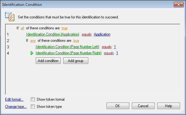

Gray University developed a new application form for new applicants. Their old application forms are still in production, so they now have two forms. Both form types have the word "Application" at the top, but the page numbers have moved from the bottom left of the page to the bottom right of the page. Therefore, in order for a document to be considered the first page of an application, it must have the word "Application" at the top and a number "1" either in the bottom left or bottom right corner.
- (Application) equals Application.
If any of these conditions are true:
- (Page Number Left) equals 1.
- (Page Number Right) equals 1.
