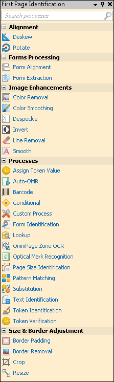

To configure a process in First Page Identification
  1. In the Session Configuration Pane, select the First Page Identification stage under the Closedname of the document class the documents will be assigned to.
  2. In the Tasks Pane, select the Closedname of the process.
  3. Configure the properties of the process. For more information, use the wizard and the help files for that process.
  4. When you encounter the Identification Condition property, follow the steps described in the Identification Conditions section of the help files.
  5. Optional: To test the configuration, select Test Processes or Test Current Process. For the best results, add a custom sample page before testing. Adjust and test until you are satisfied with the results.
