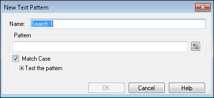

  5. Click Add Pattern. The ClosedNew Text Pattern dialog box will appear.
  6. Specify a name for the pattern.
  7. Specify a pattern to match. For a list of common expressions, click the pattern button. For more information, see the Regular Expression Reference.
  8. To make the pattern match case sensitive, select Match Case. To make it case insensitive, clear it.
  9. To test the pattern, click the plus sign next to Test the pattern to expand the Test Value box. Specify a value that you expect to fit the pattern and the expected value will be displayed under Result value as you type.
  10. Click OK.
