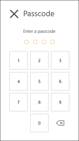

Passcode Protection
Copies of offline documents can be passcode protected. This ensures that sensitive documents will be secure in the case your device ends up in the wrong hands.
To passcode protect copies of offline documents
  1. Press the Settings button in the bottom left of the menu.
  2. Press Turn passcode on.
  3. Enter a new passcode, then re-enter it to verify it.
    Enter a passcode.
  4. Press Change passcode to change your passcode.
Note: If your administrator requires copies of offline documents to be passcode protected, you will be prompted to set up a passcode the first time you try to save a copy of a document offline. If you change the passcode, all copies of offline documents will be removed from your local device.
