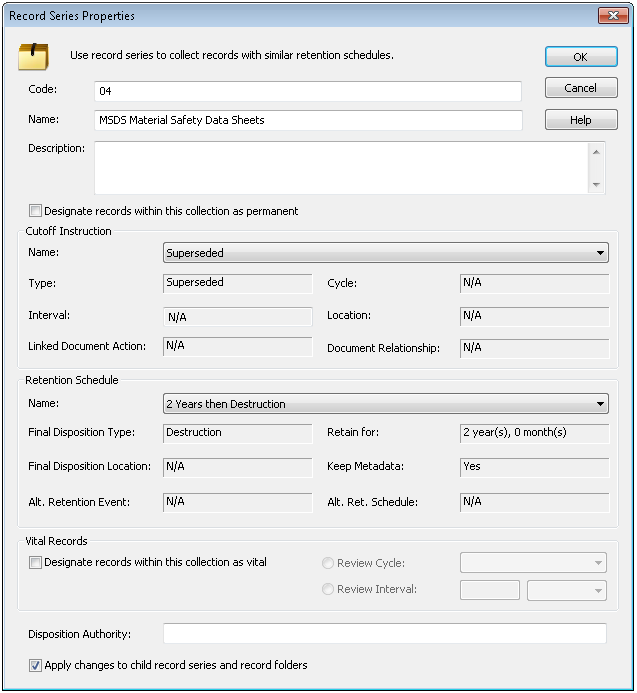

To assign cutoff instructions
Cutoff instructions are assigned to record series or records folders in either the Laserfiche Client or Web Access.
Tip: Assign cutoff instructions at the record series or record folder level and apply the changes to child entries. Note that cutoff instructions that are explicitly assigned
will override inherited properties.
- Select a record series or record folder that you want to assign a cutoff instruction to, and then select View Record Properties from the Record drop-down menu. Or, right-click the entry and select Record Properties. The properties dialog box will open.
Show me the properties dialog box for a record series.
- Under Cutoff Instruction, select the name of the cutoff instruction you want to assign to the selected record series, record folder, or record from the Name drop-down.
- Optional: If you are modifying a record series, you can select Apply changes to child record series and record folders to update any child record series, record folders, or records that this record series contains.
Note: This option will only propagate the current set of changes to the child record series and folders; it will not update the child record series and folders to exactly match this record series. For example, if you had previously changed the record folder's cutoff instructions, and you are now designating the record series as vital and select this option to propagate that setting, the child record series and folders will be designated as vital, but the prior change to the record folder's cutoff instruction will not be overwritten.
