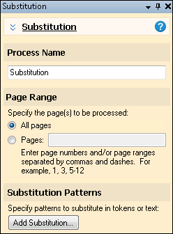

  1. In the Session Configuration Pane, select the stage of processing where you want to use Substitution.
  2. In the Tasks Pane, select Substitution.
  3. You can optionally enter a name for the process under Process Name.
  4. Move through each step of the wizard at the bottom of the pane. You can also click Skip Wizard to display and configure the properties all at once.
  5. Page Range: When configuring a process in Page Processing or Post-Processing, you will be prompted to specify a page range. In other stages, default settings will be automatically applied.
  6. Substitution Patterns: To configure a pattern, click Add Substitution. The New Substitution Pattern dialog box will open.
  7. Specify the name for the substitution. The best practice is to choose a name that will help you remember the function of the process when reviewing the session later.
  8. Choose whether to look for the pattern in an existing token value or the page text. If using a token value, you can use the token button (right arrow) to select tokens generated from the system or other processes in Quick Fields. If using page text, you can choose whether to run the pattern match on the entire page or specify a custom line range.
  9. Specify a pattern to match. For a list of common expressions, click the pattern button. For more information, see the Regular Expression Reference.
  10. Specify the data that will replace the information that matches the pattern. If you have used a match group in the pattern, you can click the button to select it.
  11. To make the pattern match case sensitive, select Match Case. To make it case insensitive, clear it.
  12. To test the pattern, click the plus sign next to Test the pattern to expand the Test Value box. Specify a value that you expect to fit the pattern and the expected value will be displayed under Result value as you type.
  13. Under Options, select Clear token if no match is found if you want to clear the token when a match is not found. If Replace the input token's value with the result is selected, the token will be modified to match the input value.
  14. Optional: To preview how this enhancement will affect scanned images and OCRed or extracted text, test processes. For the best results, add a custom sample page before testing. Adjust and test until you are satisfied with the results.
