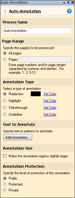

To configure Auto Annotation
- In the Session Configuration Pane, select the stage of processing where you want to use Auto-Annotation.
- In the Tasks Pane, select Auto-Annotation.
- You can optionally enter a name for the process under Process Name.
- Move through each step of the wizard at the bottom of the pane. You can also click Skip Wizard to display and configure the properties all at once.
- Page Range: When configuring this process in Page Processing or Post-Processing, you will be prompted to specify a page range. In other stages, default settings will be automatically applied.
- Annotation Type: Select a type of annotation. Annotations available in Quick Fields have the same properties as the same annotations applied in the Laserfiche repository.
- Redaction
- Highlight
- Strikethrough
- Underline
For each annotation type, you can click Set Color to change the color or create a custom color.
- Text to Annotate: When you click Add Annotation, the New Annotation dialog box will appear.
- Specify a name for the annotation that will help you remember its function when reviewing the session later.
- Specify the text to annotate. You can specify text—for example, if you want to highlight a particular word. You can also select the pattern button to use pattern matching expressions to annotate any text that matches a particular pattern (such as a social security number). Select Test to enter a sample value and see whether the regular expression works.
- Specify a description that will help you remember the purpose of the annotation and the regular expression when reviewing the session later.
- Click OK.
- When you click on the summary of the annotation, the Edit Annotation dialog box will appear and you can modify any of these settings.
- Annotation Size: When Make the annotation regions slightly larger is selected, the annotation will become slightly larger. This can help ensure redacted data is fully covered.
- Optional: To preview how this enhancement will affect scanned images and OCRed or extracted text, test processes. For the best results, add a custom sample page before testing. Adjust and test until you are satisfied with the results.
- Annotation Protection: Select if you want the annotation applied to be
- Public: The annotation will be visible to everyone.
- Protected: The annotation can only be modified by its creator or document owner.
- Private: The annotation will only be visible to its creator.
