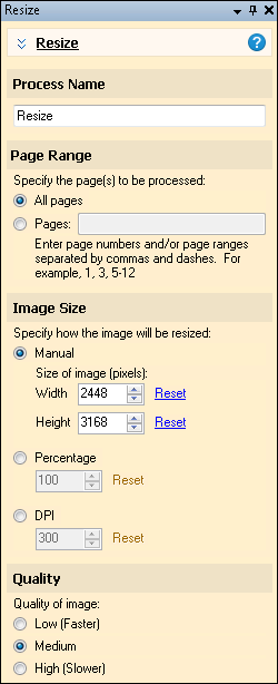

To use Resize
- In the Session Configuration Pane, select the stage of processing where you want to use Resize.
- In the Tasks Pane, select Resize.
- You can optionally enter a name for the process under Process Name.
- Move through each step of the wizard at the bottom of the pane. You can also click Skip Wizard to display and configure the properties all at once.
- Page Range: When configuring an image enhancement in Page Processing or Post-Processing, you will be prompted to specify a page range. In other stages, default settings will automatically be applied.
- Image Size: Specify the new image size.
- Manual: Resizes to an exact width and height (in pixels). Regardless of the image's new size, its resolution will not change. This may lead to a lower quality image, as pixels may be stretched or shrunk.
- Percentage: Resizes the image proportionately, maintaining the same resolution and level of quality.
- DPI: Resizes the width and height to a specified DPI (dots per inch).
Example: If the original image has a resolution of 300 DPI, and it is resized to 600 DPI, the image's width and height will be doubled.
- Quality: Define a quality level. The higher the quality, the longer this enhancement will take to process.
Note: This setting only affects 8 and 24-bit images.
- Optional: To preview how this enhancement will affect scanned images and OCRed or extracted text, test processes. For the best results, add a custom sample page before testing. Adjust and test until you are satisfied with the results.
