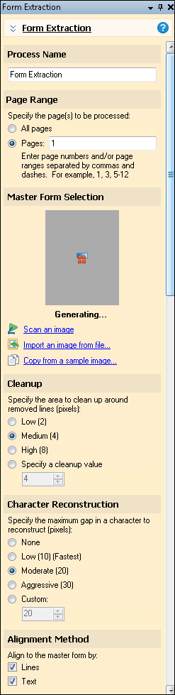

To configure Form Extraction
- In the Session Configuration Pane, select the stage of processing where you want to use Form Extraction.
- In the Tasks Pane, select Form Extraction.
- You can optionally enter a name for the process under Process Name.
- Move through each step of the wizard at the bottom of the pane. You can also click Skip Wizard to display and configure the properties all at once.
- Master Form Selection: The master form is an image of a blank form that matches the forms you will be processing. In Form Extraction, the lines and text of the blank master form will be removed from the forms that are filled in, leaving only the data entered on the form. There are three ways to add a master form:
- Scan an image: Scan in the master form using the currently configured scan source.
- Import an image from file: Import an image that is currently stored in a network drive.
- Copy from a sample image: If you have already added a custom sample image that is the same image you want to use as the master form, you can copy it.
- Page Range: When configuring an image enhancement in Page Processing or Post-Processing, you will be prompted to specify a page range. In other stages, default settings will automatically be applied.
- Cleanup: This option helps you compensate for forms with blurry or fragmented lines and shapes by expanding the region within which Quick Fields will look for elements that correspond to the master form.
Example: Selecting Medium (4) removes all stray marks located within two pixels from a line.
- Character Reconstruction: Characters that intersect lines may be damaged during line removal. The Character Reconstruction option repairs any damaged characters. Specify the scope of character reconstruction. The numbers represent the maximum gap, in pixels, of a character disruption to be reconstructed.
Tip: If damaged characters are not sufficiently repaired during processing or testing, select a higher value. If characters are improperly repaired, select a lower value.
- Alignment Method: Choose which components of an image will be used to match it to the Master Form.
- Lines: Use lines to match the image to the Master Form.
- Text: Use text to match the image to the Master Form (horizontal text only).
- Lines & Text: When both Lines and Text are selected, lines will be used first. If the lines to not clearly identify a match, the text will be used to match the image to the Master Form.
