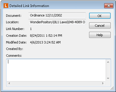

In the
Detailed Link Information dialog box , you can view additional information about a link group member. See To view or modify link group information for a document (above), for instructions on opening the Detailed Link Information dialog box. (This information is available in the Metadata Pane or dialog box in Web Access without needing to open an additional dialog box.) The following information is available:
Note: Gaps in the link group numbering represent documents that were either removed from the link group or deleted from the repository.
Note: Link group comments only the link group member on which the comment was set. They do not apply to all documents in a link group.
