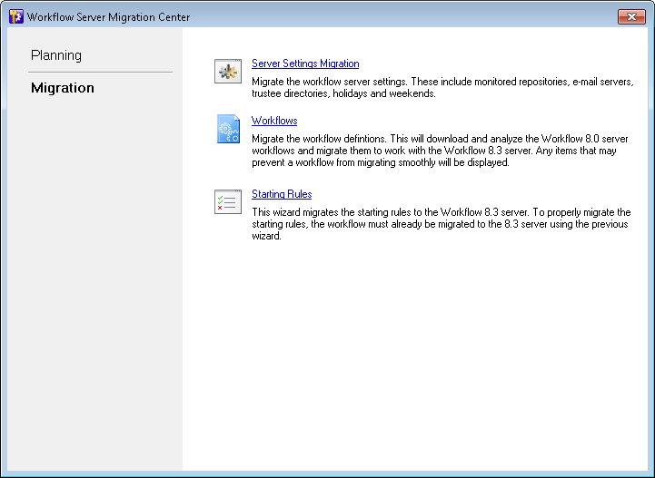

  1. In the Workflow Server Migration Center, click Migration (in the menu on the left). The Closedthree wizards on the right will guide you through the migration process.
  2. Run the Server Settings Migration Wizard to migrate Workflow Server settings such as monitored repositories, e-mail servers, trustee directories, holidays, and weekends.

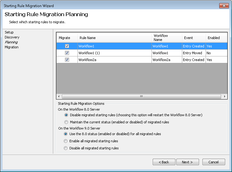

    5. A Closedlist of the starting rules you can migrate will appear along with the workflow each rule is associated with, the rule's starting event, and if the rule is enabled or disabled. You can organize the listed starting rules by if they will be migrated, by Rule Name, by Workflow Name, by starting Event, or by if they are enabled by clicking the column headers.
    6. Below the list of starting rules, configure the status for all migrated starting rules.
    7. Note: You cannot have the same starting rule enabled on both the Workflow 8.0 Server and the Workflow 9.0 Server, so you must choose which Server the rule will be enabled on, if any.
    8. In the Migrate column, select the checkbox next to the starting rules you want to migrate and clear the checkbox next to the starting rules you do not want to migrate.
    9. Tip: You can migrate all starting rules by right-clicking on the list and selecting Select all. To not migrate any starting rules, right-click the list and select Clear all.
    10. Optional: To see starting rules that have already been migrated, right-click the list and select Show already migrated starting rules.
    11. Click Next.
    12. The selected starting rules will be published. After the progress bar completes, a list of the migrated starting rules will appear. Click View Migration Log to see the details of the starting rules' migration. Click the status link next to each rule to see details about the rule's status. You can organize your starting rules by Name, Type, or Status by clicking the column headers.
    13. Click Finish.
