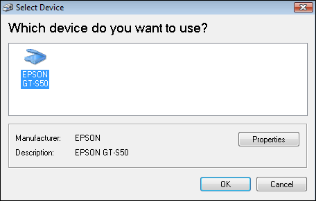

  4. Choose a scanner from the ClosedSelect Device dialog box. If your scanner is not listed, install the scanner's WIA driver. Click OK.
  5. Note: Click Properties to configure specific properties for the scanner you are using.
