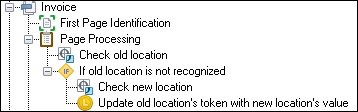

Example: The City of Graceland recently updated their invoice forms and moved the invoice number from the top left of the invoice to the top right. All the other information on the invoice is the same, but because of this one difference, they now have two types of invoices. Instead of creating an additional document class to account for this change, they can use a Conditional process, some Zone OCR processes, and an Assign Token Value process to retrieve the invoice number. First, they would add a Zone OCR process under Page Processing that will read the top left of the invoice and save the value as a token. Then, a Conditional process could be added that will check that Zone OCR value and if it does not equal an invoice number, it will run another Zone OCR process that will read the top right of the form and save that value as a token. They now have two tokens and are not sure which one is the correct one. In this case, they could add an Assign Token Value process in the Conditional under the Zone OCR that would replace the first Zone OCR's token value with the second Zone OCR's token value. Now, they will know that the first Zone OCR's token will always have the correct value and they can use that token in their Invoice Number field with confidence. ClosedShow me what this looks like.

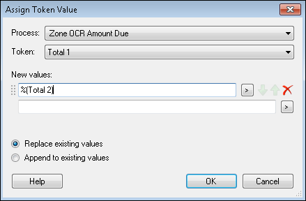

    2. In the ClosedAssign Token Value dialog box, select the process that produced the token you want to modify from the Process drop-down menu.
    3. Select the token from the Token drop-down menu.
    4. Type in a new value for the token, or click the token button (right arrow) to use tokens. You can select Token Dialog from the token button drop-down menu to modify and format tokens.
    5. If modifying a multi-value token, you can select if you want to replace the existing values or append to them.
    6. Click OK.
