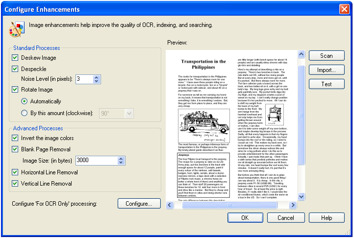

- In the
Configure Enhancements dialog box, choose from the following:
- Deskew Image: Straightens images that have been scanned at an angle.
- Despeckle: Removes stray marks from scanned documents. Specify a Noise Level to configure the smallest character size (in pixels) that should not be removed.
Example: A period in Times New Roman 12-point font is two pixels tall and two pixels wide. Setting the despeckle noise level to be three (i.e., three-by-three pixels) would protect periods printed in this font from being removed.
- Rotate Image: Rotates a scanned image. Configure whether this process should be performed automatically or by a specific amount (in degrees clockwise). Automatic rotation will detect the correct orientation of your images and attempt to rotate them to match.
- Invert the image colors: Reverses the colors present on an image. This process can be useful for converting white text to black, which is more conducive to OCR processing.
Show me an example.
- Blank Page Removal: Deletes a page from a document based on the image's size (in bytes).
Give me an example.Example: 1000 bytes equals 1 kilobyte. An image of a typical blank white page is 3,000 bytes.
- Horizontal Line Removal: Removes horizontal lines from scanned images to improve OCR accuracy.
- Vertical Line Removal: Removes vertical lines from scanned images.
- For OCR Only: With the exception of Blank Page Removal, image enhancements can be set to For OCR Only. This configures Laserfiche Scanning to undo changes made to an image after OCR processing is complete, enabling you to preserve the original state of an image. Select Configure to define which enhancements should utilize this feature.
- Sample Image: To preview how image enhancements will affect scanned images, select Import or Scan to acquire a sample image. Sample images should be as similar as possible to the document(s) you will be scanning. After acquiring a sample image, click Test to display a preview.
