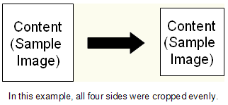

This image enhancement removes an outer portion of an image, reducing the image's overall dimensions and file size. The unremoved portion remains at the same scale and resolution.
ClosedShow me an example.
Note: This enhancement is performed regardless of content, potentially removing important data.

  5. Define the Closedregion to be removed (in pixels). If zero is entered, the side in question will not be cropped. ClosedShow me an example.
