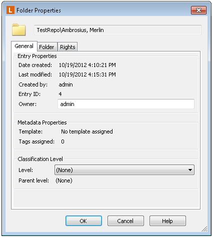

In Laserfiche client applications, a classification level can only be set on a document if its parent folder has had a classification level set. Otherwise, the classification level option will be hidden. Users must be granted the Manage Entry Access privilege in order to set classification levels on entries in the Laserfiche Windows client applications. Note that entries created in folders that have classification levels set will match their parent's classification level, although users with the Manage Entry Access privilege can manually choose another value for those entries.
Every classification level has a numeric value that determines how restrictive that level is. If a classification level has been set on an entry, that entry can only be moved to a folder whose classification level is the same or lower than the value of the entry's classification level. By default, folders in the repository start with a classification level of "None," with a value of 0, the least restrictive possible value.
The classification levels that can be set on folders are restricted based on both the classification level of the folder's parent folder and the classification levels of the folder's child folders. A folder's classification level can only be set to a value equal to or lower than its parent folder's value, and a value equal to or higher than the highest value assigned to any of its child folders. Thus, if a folder's parent has a classification level value of 7, and its child folder has a classification level value of 3, the available values for that folder's classification level are 3, 4, 5, 6 and 7.
