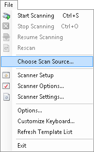

  1. Select Choose Scan Source under ClosedFile in the menu bar.

  4. Select Scanner Options under File in the menu bar.
